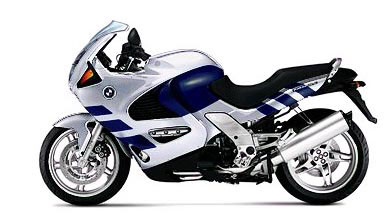

Hi all bike is a k1200rs on a 2000 plate went for run to day put fresh fuel in it went on my merry way went some 20 miles no probs going down a hill bike cut out got to a safe place couldnt bumb starte it on the hill all ignition lights okay bike turns over no probs any body got any ideas yours paul
Re: bike stopped on run
hi all had a look at the plugs good spark but plugs are dry when i took one out after trying to start it yours paul.Hi all bike is a k1200rs on a 2000 plate went for run to day put fresh fuel in it went on my merry way went some 20 miles no probs going down a hill bike cut out got to a safe place couldnt bumb start it on the hill all ignition lights okay bike turns over no probs any body got any ideas yours paul
