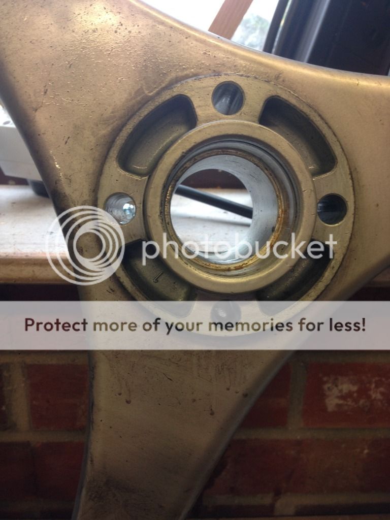

Hi Ian aka Shirley......it could stick you know!
Plug leads, they are full of rubber. Just re-align the metal and nip it up again.
Good joke, big chuckle bro.

Well Phil thanks for the tip, all nipped up and looking like the others:

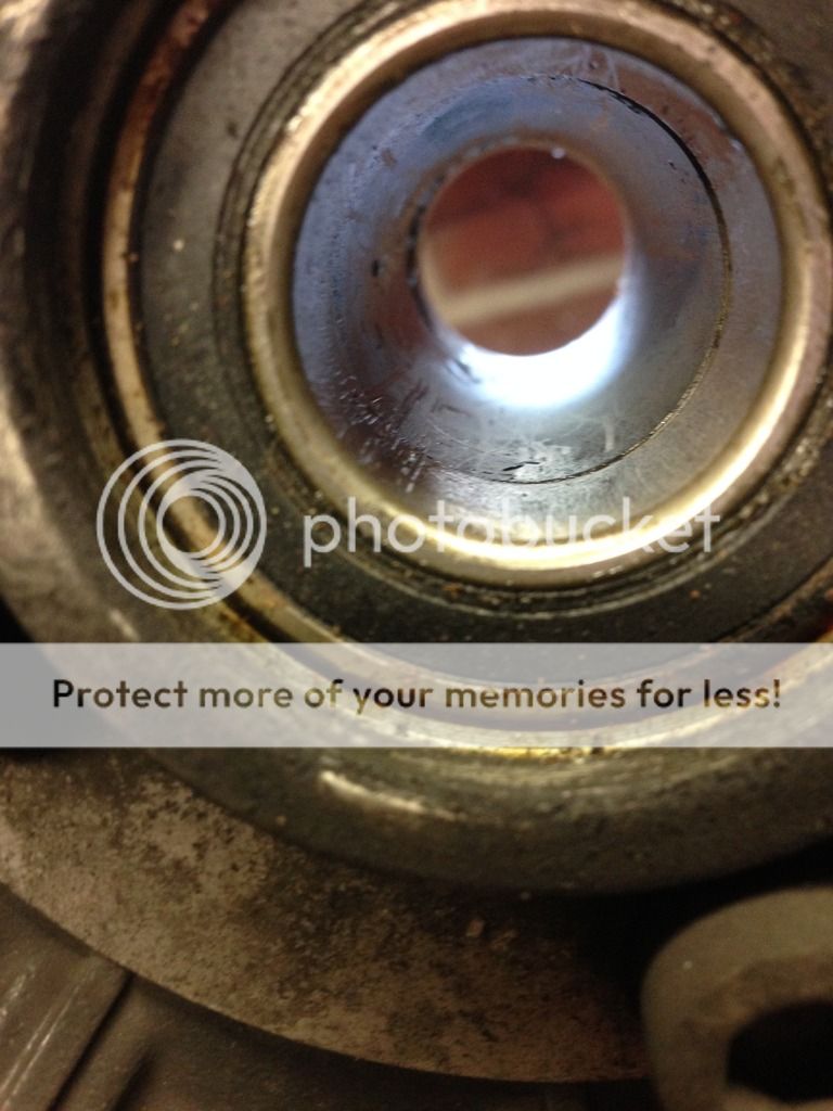

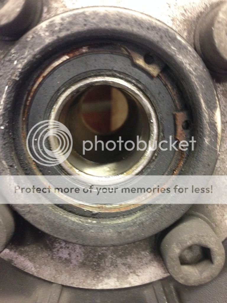

Next attacked the wheel bearings, they did not look too good on the outside but spun up ok, but gonna change em anyway:

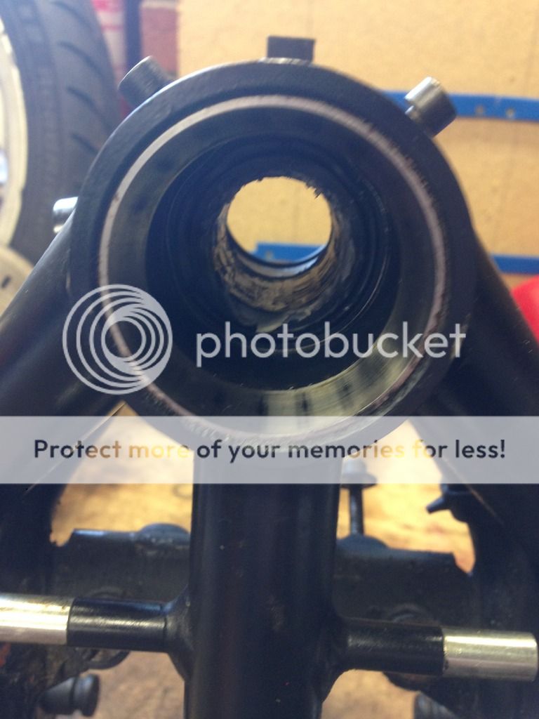

Next up was the head bearing races, bit of a nightmare as I wanted to leave the fluidbloc in place, still all out ready for the frame to be done:

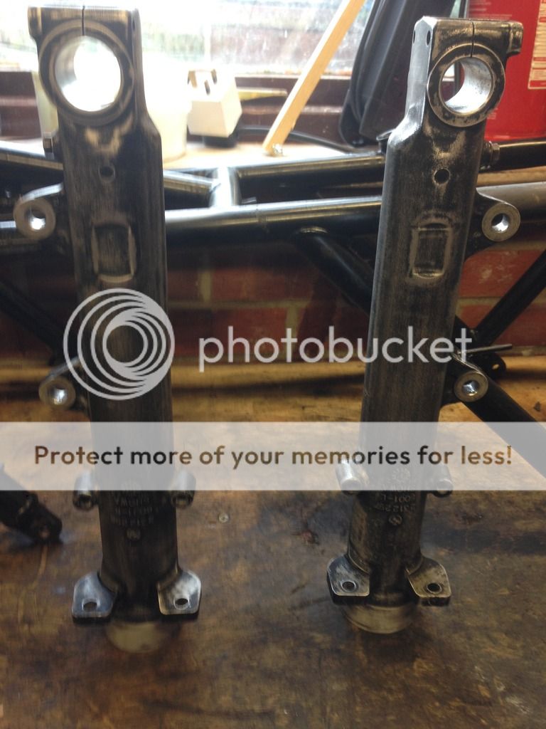

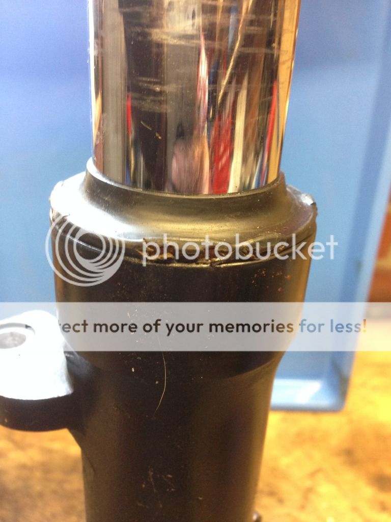

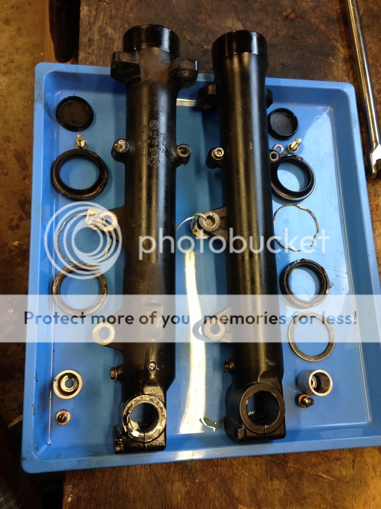

Next up was the forks, someone had mullered the dust seals, what a prat as they came out easily enough, lots of crud underneath:

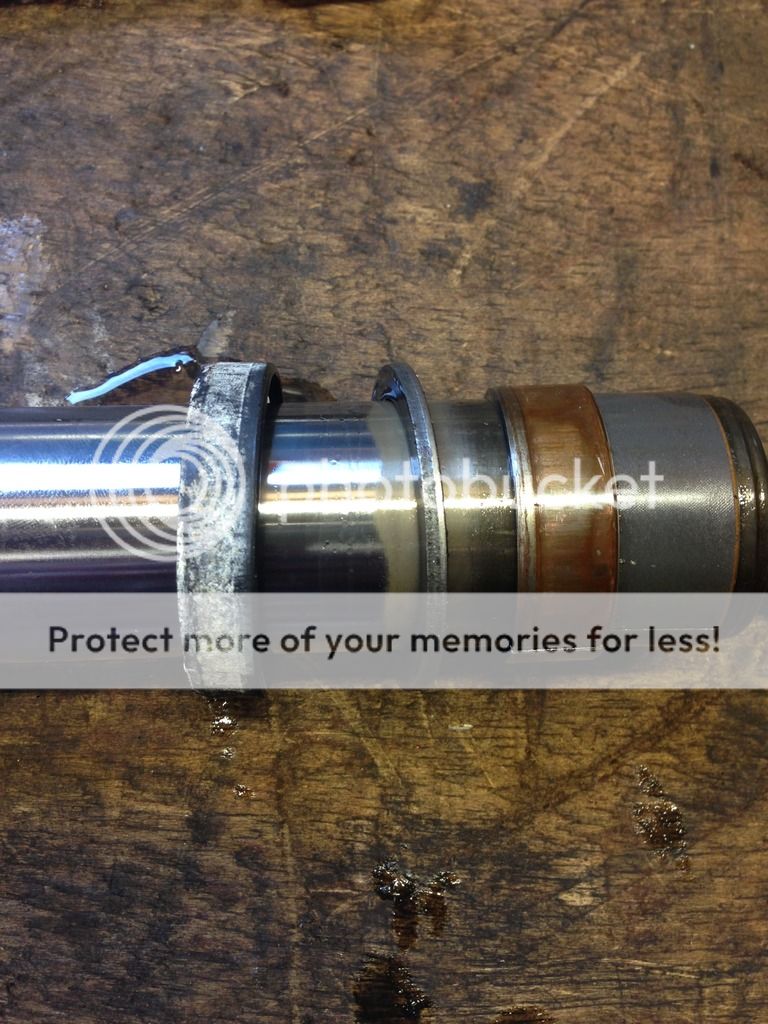

Seals not much better:

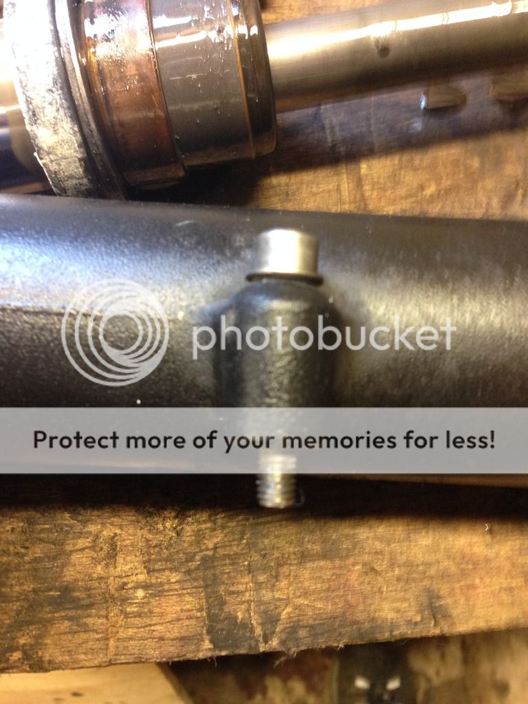

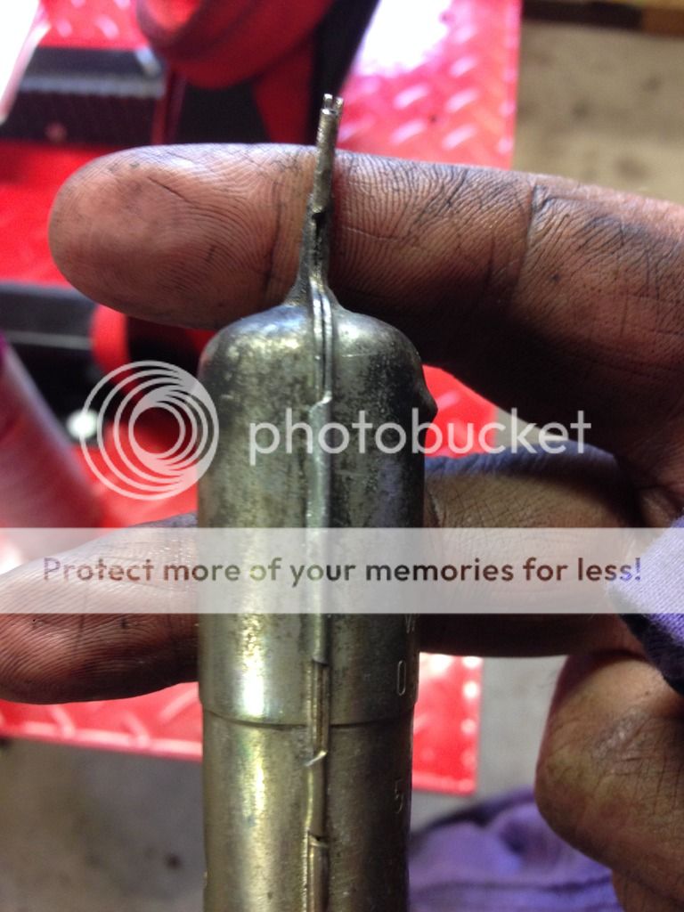

Finally the mandatory stuck mudguard bolt, glad I did not miss the experience:

That head race is knackered, I assume you are fitting new ones?

Your assumption is correct that's why I knocked em out yesterday.

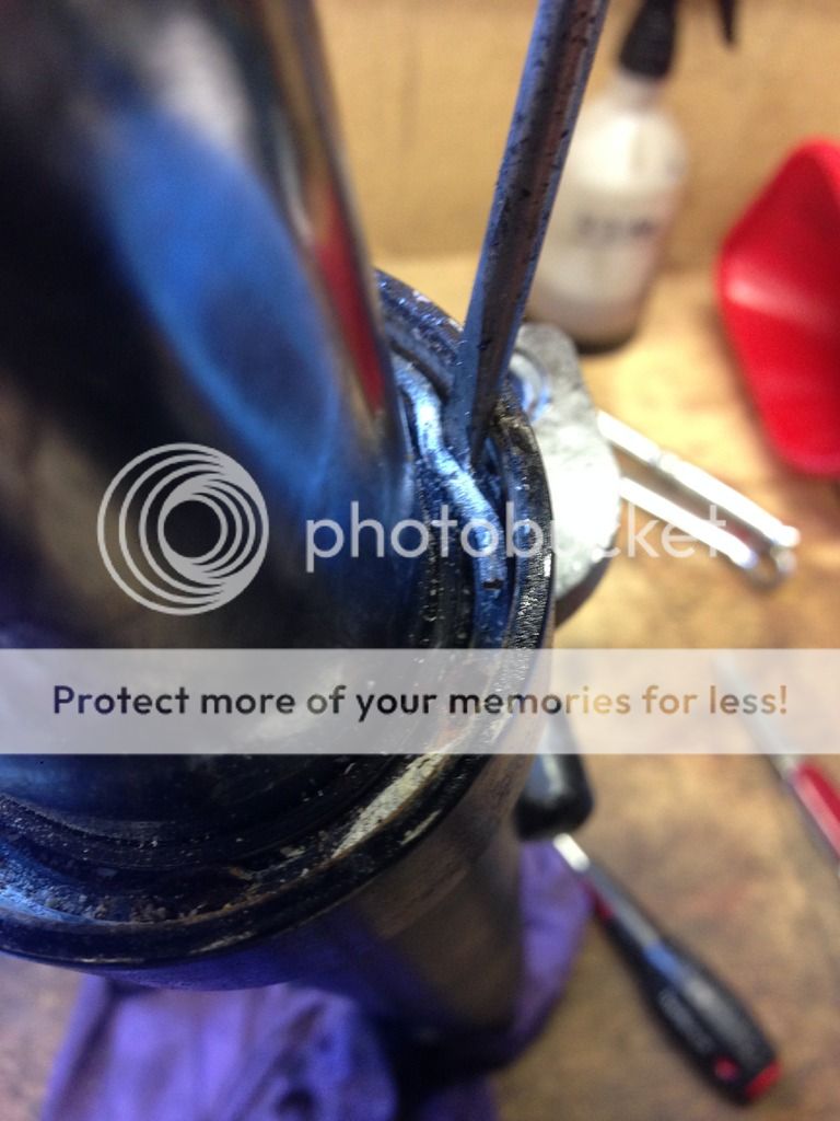

Stripped the forks down today stauncions ok so that good, needs new seals and dust caps:
So big order off to Motoworks tonight and now I have the wheel to clean up, the fork sliders to clean and paint and the frame to clean and paint. The frame is quite rusty in places.
I am not going to strip down the fork internals as I put in progressive spring before I gave it away to me mate, so they should all still be good.

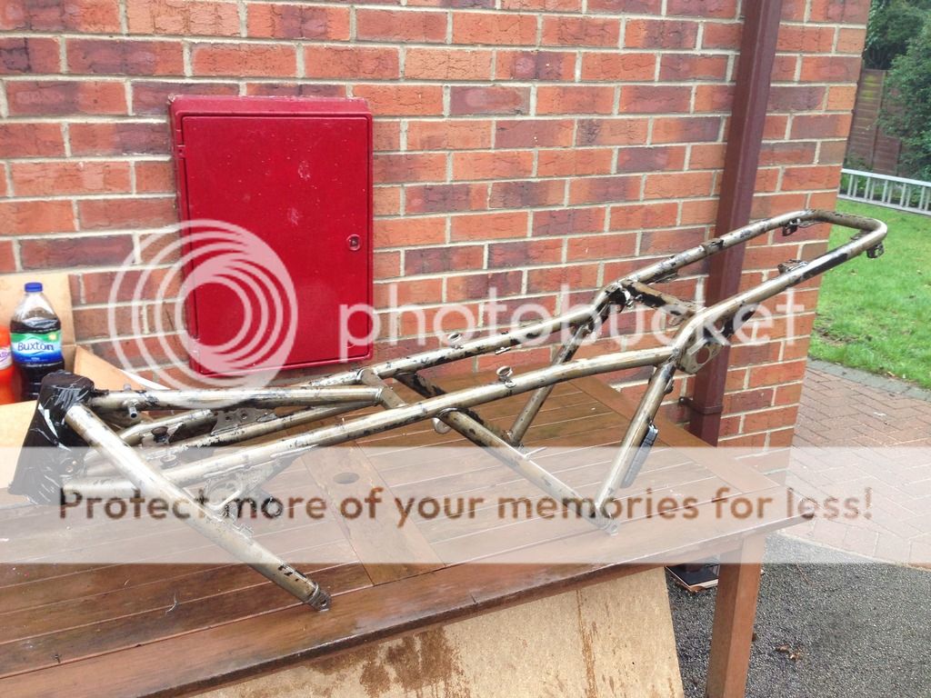

Postby Ian T » Tue Feb 21, 2017 6:49 am

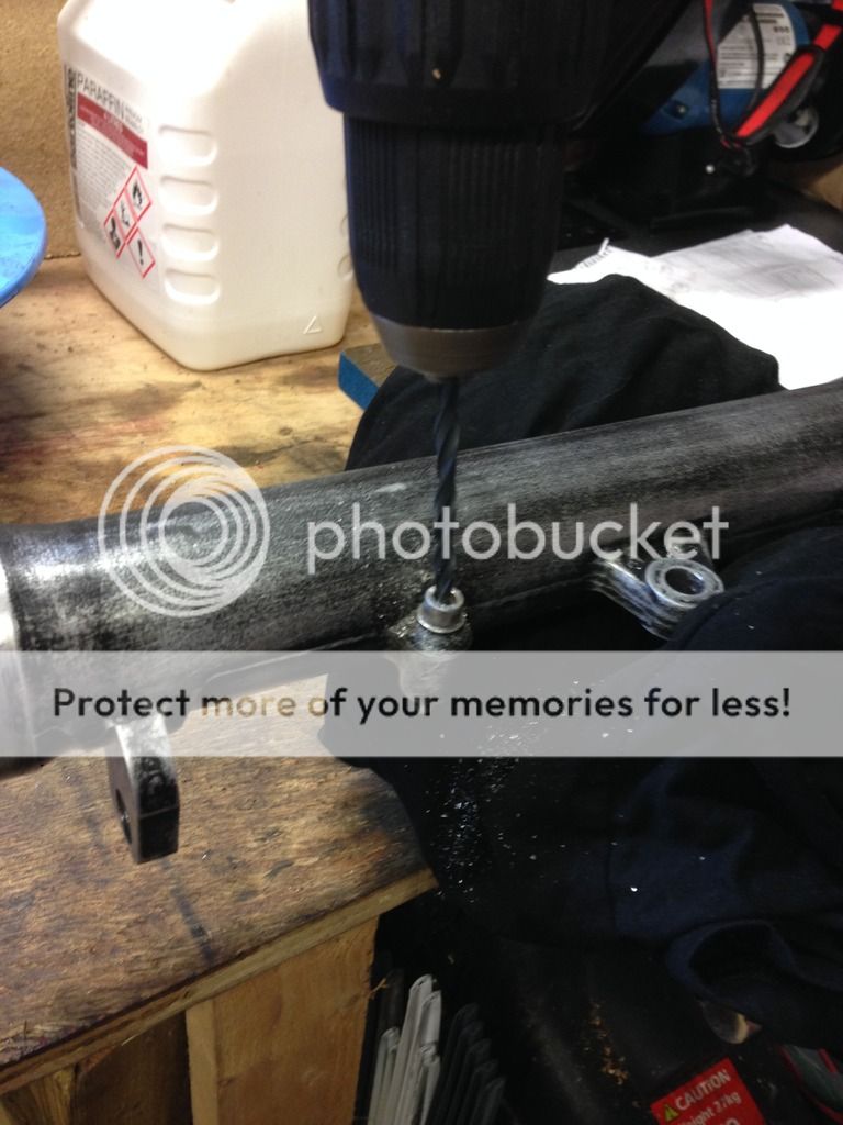

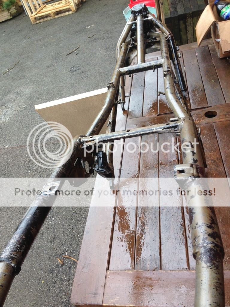

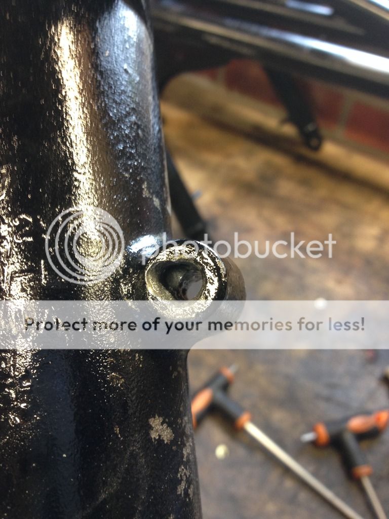

Not a good day today, I had forgotten how wonderful an adventure it was to mindlessly rub down and prep for painting.
I first had to drill out the two remaining seized bolts:
It is a pity that the wazzock who had a go last time in the bikes life could not drill straight, but it should not be too much of a problem considering they are not too big a load bearing point:

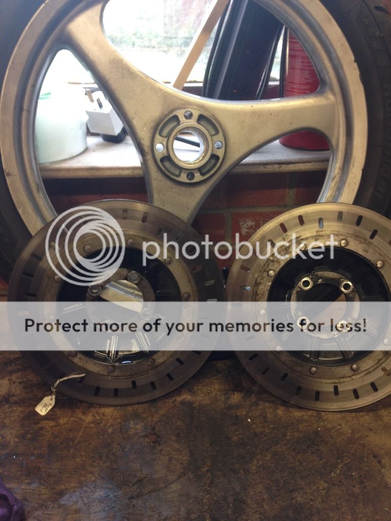

The forks are ready now took ages with sandpaper then some wet and dry but all de-greased and ready for a bit of paint:

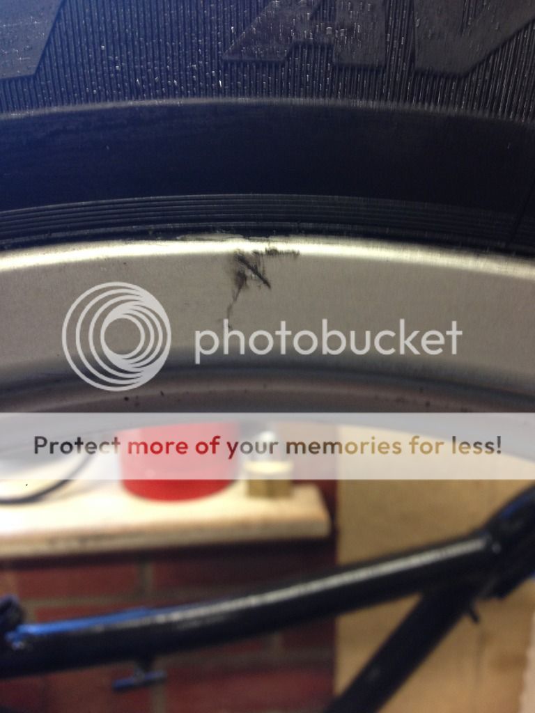

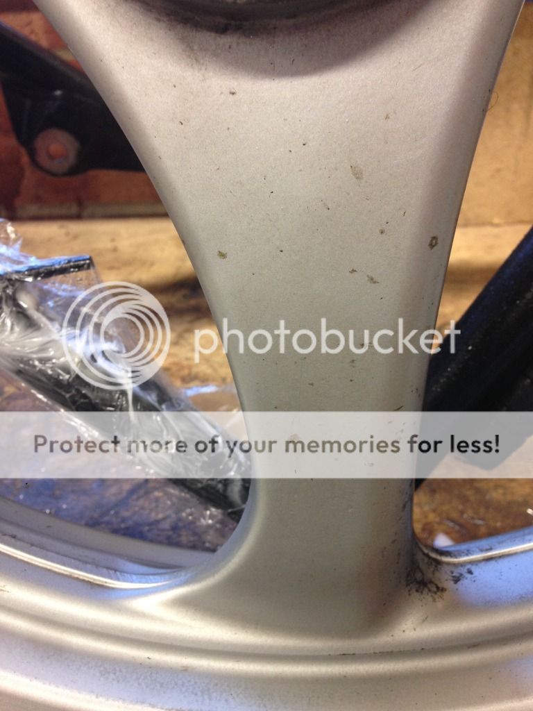

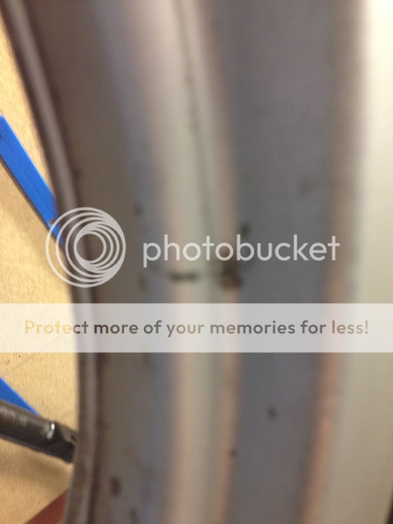

Started to clean up the wheel and a bit disapointing as there are some small blemishes, I did not want to have to paint the wheels as the nice chap put new tyres on a few months ago, not Bridgestones, Avons instead, still you can't have everything:

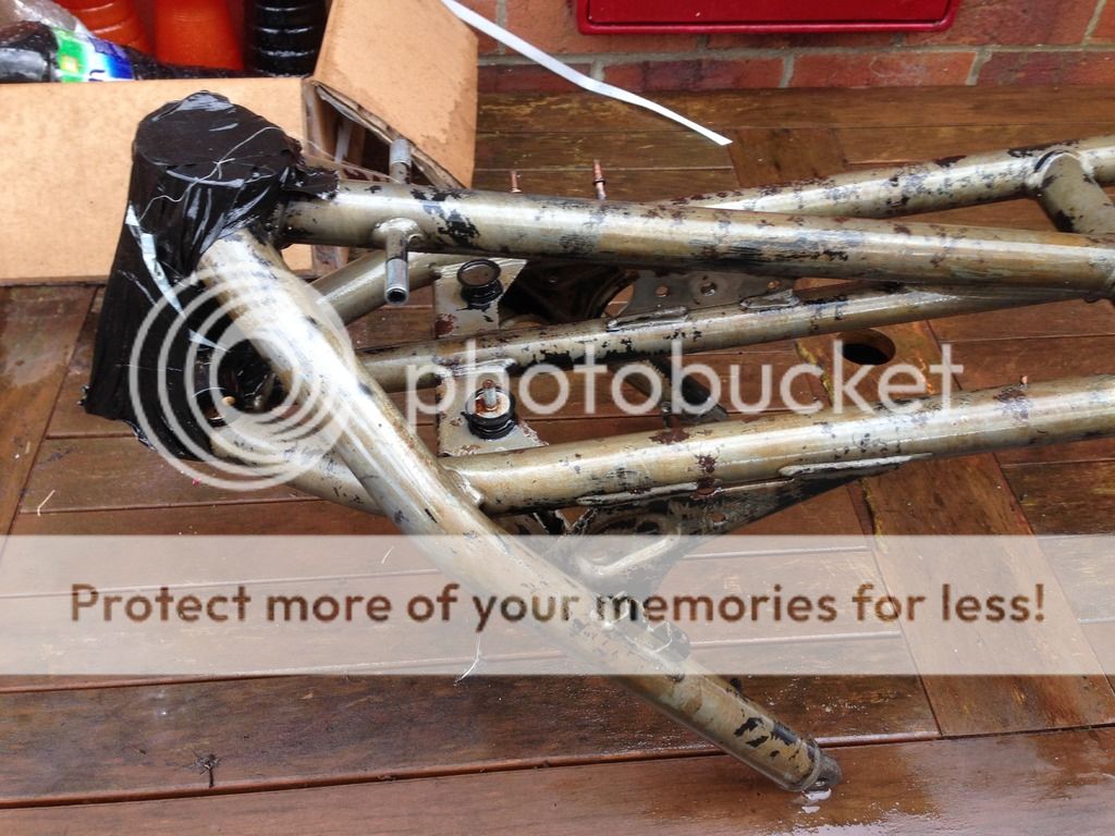

Started to sand off the frame, at this point I lost the will to live, brought some stripper from Screwfix, looks like it is going to be as much use as a chocolate fire guard, so slathered another coat on and wrapped it in cling film, may help if not it will have to be wire brushes, but I don't like them as too aggressive.

either screwfix or toolstation sell a plastic panscrubber type mop with grit, I have not tried them but think they look ok to remove paint

I will pop down today, I think I know the sort and it must be easier. I got some paraffin from B and Q £6.99 for four litres daylight robbery, and I went to a proper automotive supplier and got some slow panel wipe and tack cloths so all should be good for a paint up.
Just found out you can get 2k in aerosol, how good is that!
I'll let you know if the pads work

Try this - I use them for stripping paint off wooden doors - works well and far better than paint stripper.
https://www.ebay.co.uk/itm/291748656544
Kerosene from your CH Oil Tank is the same as Paraffin and a lot cheaper!
Also good for cleaning oil-based paint off brushes.

Hi Ian,
I admire your heroic efforts to drill out the mudgard bolt. I think they cause more grief than a difficult wife. Just for future ref...use a 4mm cobalt drill if you need to go right through. Follow with 6mm if first drill went right down the centre. Stainless steel bolts will work harden if you use a normal drill and then be undrillable. My fave method is to drill, saw or grind off the bolt head and use the protruding thread at the other side with a lubed up nut and packing washers to draw out the stub. If you are totally committed to drilling and you go off line then saw off the protruding thread and start again from the other side with a decent centre punch mark. I would only do this if the bolt has snapped off. Usually they will yield to the nut and washer method.
For a chap like you with time on his hands a leisurely soak in penetrating oil (not WD40) will pay dividends. It works great on rusty nuts and bolts too!
I think you need to paint/powder coat the wheels. After all you have taken the bearings out...with heat I trust. These 3 spokers have such a large surface area they have to look good. It's worth trying a rattle can.

Postby Galactic Greyhound » Tue Feb 21, 2017 2:28 pm
Rub 'n Buff 'Silver Leaf' colour might help tidy up the wheels if you don't want to paint. Available on Ebay.
I've just used it for the first time on my R1100RT fork sliders which were looking a bit grotty after 20 years use.
Clean and degrease smoothing off any rough surfaces and apply VERY sparingly with a toothbrush (Tip: Use the wife's) then buff to a shine with a cloth.
The sliders look much better now and the wife is getting a nose ring to go with her silver teeth -very Goth!

Cheers Ced and George I got some yesterday should be a lot easier, ruined me nails already!
That Rub n Buff stuff looks really good first came across it here when I had me R80 about 2010, it does produce some amazing results. Mentioned to the wife about the Goth movement, not seen her since.
Alas I am on gas heating or I would have raided the tank already, but thanks.
Phil, what a great method to use, got em out anyway used mole grips on the stud but, but thanks really appreciate it.
"With heat I trust" - ha ha I an ex Marine with a big hammer.....................
You are all right they have to be painted, fancy powder coat but my aim is to do everything myself and not farm out anything this time, I see lots of tinternet things where people have painted their wheels with the tyres still on, I have never taken this approach before as I have always had the tyres off, but given they are brand new - what do people think about this approach of painting with tyre on, is it just laziness or a sensible approach

Postby PhilO » Wed Feb 22, 2017 12:06 pm
I favour the naked aproach to wheel painting. It gives you the chance to clean up the tyre bead area where all slow leaks eminate. Yer average tyre fitter is just a quick 'off and on' merchant and ignores the inevitable corrosion in this vital region. You can get the tyre off easily enough if you keep it beside the Aga for a day to soften it up then get your friendly motorcycle tyre fitter to replace it using his rim guards and plenty of lube.
I have painted on the rim by deflating the tyre to get the masking tucked under a bit further. I would replace the bearings first or you could ruin the paint work when you re-fit them.
You could always remove the tyre yourself. Clean up and paint the inner surface then replace the tyre. Paint the rim with the tyre deflated then reflate and get the balance done by the pros, although it is not impossible to do the balance yourself before you fit the brakes.
I suppose most folks would just mask the tyre and blow the paint on...and why not? Life's too short any way.

As always Phil your words are wise and can't do a half baked job so the tyres off and I will do the wheels properly. Had a little rub and the lacquer and paint do not appear to hard on. So should be easy to strip.
Frame half stripped of paint hope to finish it off tomorrow.

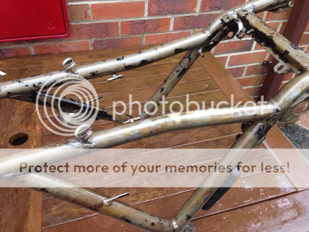

Postby Ian T » Thu Feb 23, 2017 2:55 pm
Well that's the frame sorta done, I now need to get at it with the paper and wheel. Still most of it off so should not take that long, all done in the eye of windy Doris.
Well that's me for the day cos it is raining had

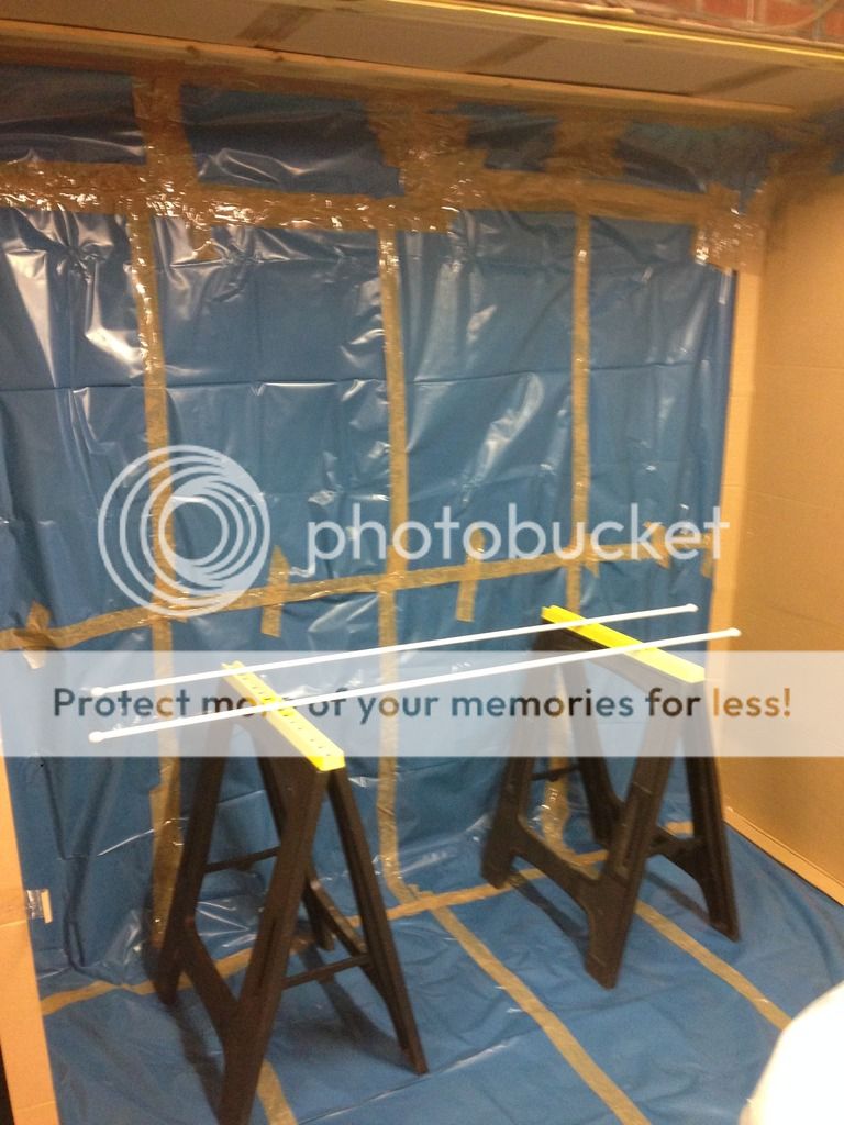

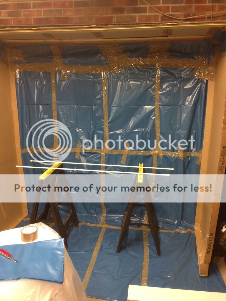

Postby Ian T » Tue Mar 07, 2017 4:28 pm
Well that's the new bathroom fitted and the kids have all gone home again so I can get on a bit.
Built the spray bay today, looks rather snazzie I think:

Postby george baker » Tue Mar 07, 2017 9:52 pm
hi
your own spray booth, neat
george
