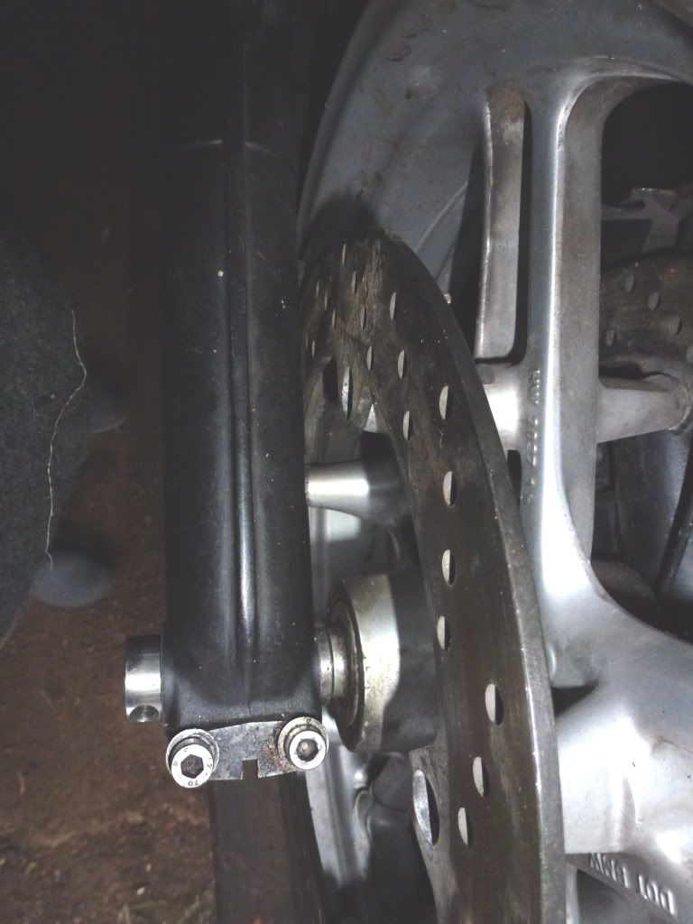

The part that so far has caused me the most grief is the front wheel spindle !! ](*,) After 2 non starts and wasted time [ 7 months ] due to suppliers not coming through, I finally went to Phil Denton Engineering - whose main activity is reproducing OEM Japanese bike wheel and swing arm spindles. One week later and - spanking new spindle !
Attached is a pic to show what needs doing if anyone wants to fit the K1200 or R1100 5 spoke wheels. The rear wheel goes straight on, and although I don't have clearance issues with exhaust or stand - there's several people done this with otherwise stock [ K1100 ] bikes. I'm sure the stand would have to be modified if you fit the S version of the wheel.
The K1100 fork swap into the K100 is straightforward and gives you 4 pot braking as a bonus.
The spindle also forms the spacer [ l/h in pic ], then a tube shim is required on the r/h side as the new spindle bearing size is 5mm smaller [ 20mm vs 25mm ]. That just leaves the r/h spacer, which in OEM form is a soft alloy, which on the 3 bikes I've stripped - have seen better days [ all less than 30K miles ]. So when I've determined the new length for the spacer , I'll have that made in the same grade of stainless steel. BTW - you can't just simply use a K1200 spindle !!!!!!!
That just leaves the forks to be swapped over and I can then complete the detailing and fitting of the GRP panels - then it's paint and hopefully, on the road next Spring - only taken 7 years ....... :-" :-" :-"

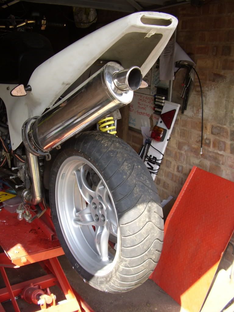

Not the best pic in the World, but especially for Dave ...............
This is the prtotype keihan
