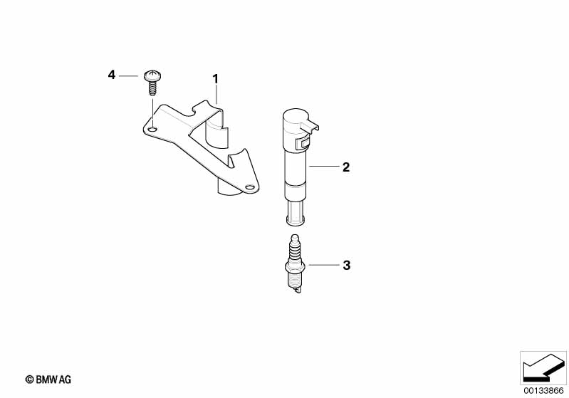

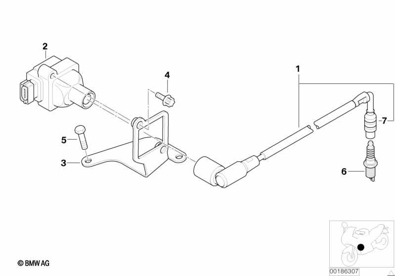

The NGK catalogue is at odds with the BMW books. NGK specify the D8EA for 94-99 and the DR8EB from 00- onwards, but they offer as an alternative iridium plug DR8EIX for all 650s from 94 onwards. The BMW parts list shows a cross over around 2003, which is when the ignition system changed. The first type uses a non-resistor plug and the second uses a resistor type plug.
Single Plug / Single Spark:
Single Plug / Twin Spark:
The 1st system has a resistive cap with a non-resistive plug (no R in code). The 2nd system has the coil on plug and a resistive plug. Having both the a resistor cap and a resistor plug isn't a good thing.
If your ignition system is like picture 1, then I'd go back to a D8EA non-resistor plug (or change the HT lead for one with a non-resistor cap).

Another thought - if you do have the version with a stick coil, your symptoms are classic signs of stick coil failure, which many people, me included, have experienced. I now carry spares!

2. How many plugs does your R1100RS take, and is there any similarity at all with my F650GS, apart from them both being BMW?
3. I got the new plug for 15 euro because it will last for 80,000 klm. Even more economical than your cheapie at 1/3 the price.
4. If I had the money you have to take my bike to a BMW dealer they would have charged me loads just to change a small part. I did pay 15 euro for the headlamp from them when I could have bought it from a local place for 5, and they didn't even diagnose the real problem. It was the connectors not the lamp, but they just changed the lamp and charged me for that plus labour. But hey, if you have money to throw away then go ahead.
4.1. I suspect that even if I had the money to pay for the electronic diagnosis they wouldn't have found the problem because even though the DR8 plug is recommended by NGK for my bike, the original BERU cap is also a resistor cap, so both don't match.
5. What a stupid system they have: a Denso coil, a Beru cap, and an NGK plug. Seriously???
6. What kind of stupid questions are you asking me? Weather conditions? irrelevant with plugs. Road surfaces? Are you £^%$^%^&%^ kidding me? After or before fuelling? Again WTF dude? Spark plugs are not susceptible to any of those things if they are properly fitted. Do you not know anything????

Does it occcur after fueling ? Silt and water can lie at the bottom of the tank adding fuel stirs it up and leads to bad running
Weather conditions if you had a cracked sparkplug cap then In dry weather it will be fine in wet weather it will misbehave when it gets wet
I have no axe to grind with you fella!
Well done in finding the problem, it is very unlikely it would have shown up on an electronic code reader as it is not as clever as people think. It can give a definitive fault for example Lamda probe short to earth .. but it cannot "see" that a fuel pump relay has failed on an R1200GS as the ECU has sent all the correct signals but the electronics have failed internally so it is not converted into switching the pump on or off
